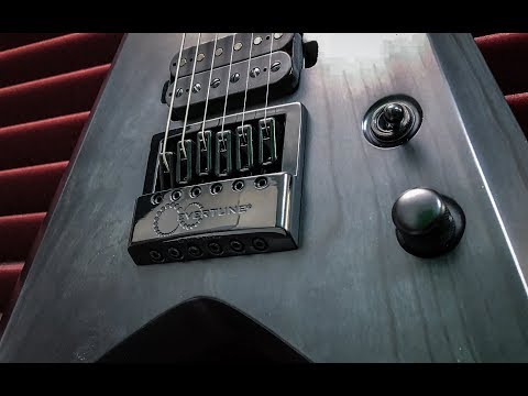

  • The guitar itself - just a used MIM Telecaster, the bridge + install cost more than the guitar itself.  I couldn't bring myself to get an existing guitar modded in case I didn't like it.  The guitar has Bare Knuckle Flat 50's fitted which sound great.
    I went for the brushed nickel bridge, I felt like the chrome was a bit too shiny for my tastes.  The pickup needs to be installed upside down but it's not an issue.

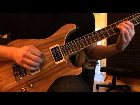

    my other VGS is the one 2:00 into this video:
    I have not altered this one at all. IN fact I have not retuned it or played it for over a year (neck is ~Mex quality, so not as popular as my other guitars with me), let me try it now:
    all 6 strings in tune, but they are all about 1 or 2 cents below normal pitch, so it probably needs a tweak
    I think I should put a new neck on this
    My fingerboard on my main guitar is the same as on the first guitar in this video, but without that model is a bit too metal-looking and I don't like the EMG SLVs (https://www.amazon.co.uk/VGS-Radioactive-Denander-Signature-Evertune/dp/B0098NB9GY)
