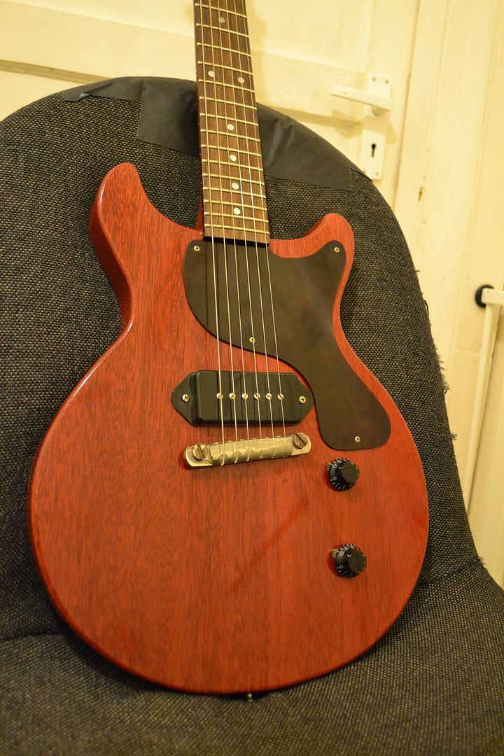

  • IvisonGuitarsIvisonGuitars Frets: 6838
    So, once hardened, the hardware was fitted and off it went to the 'top secret ageing booth'........the freezer.
    And a few hours later, lovely checking!
    So this is where we are at the moment. i'm currently giving it a couple of hours sunshine a day and it's already showing signs of fade. I need to darken the back of the guard as it's too light a colour for my liking. But so far things are looking good!
