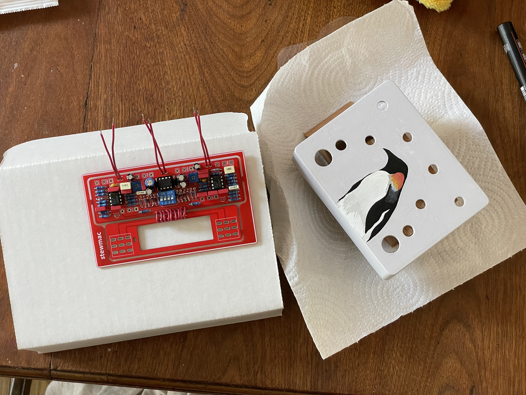

    A few weeks ago I built a Fuzz Factory pedal and thought that it might look cool if I hand painted a bare enclosure with Posca pens and sprayed it with Rustoleum gloss clear coat.
    Wrong. It didn't look cool and any Rustoleum product is crap (their paint is like treacle, and their clear coat disintegrates). It would have looked better if I had poured a bucket of cold sick over it:
    before

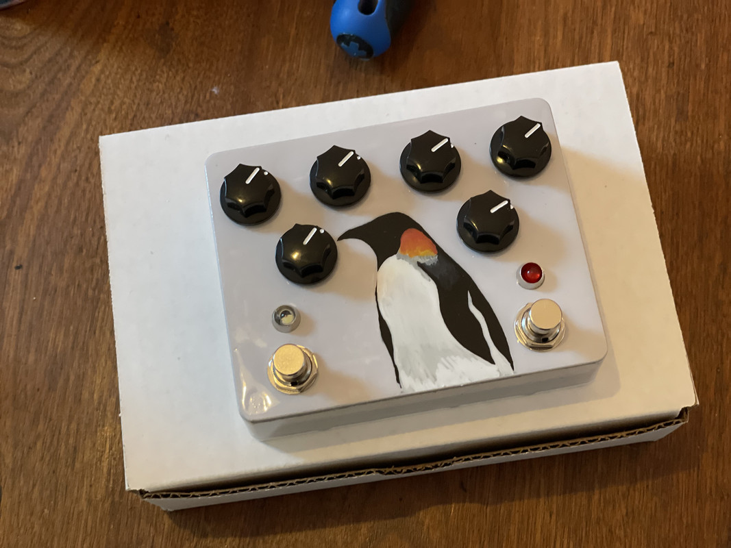

    So, this week I disassembled the pedal, sanded it down and re-did the finish with a printed sticky decal and covered it with Envirotex Lite. It's an improvement I think:
    after

    The new Fuzz Factory looks good @Philtre ;
    Any chance you could get some close up photos on what the edges look like where the envirotex finishes please? I assume the ET only covers the top and doesn't cover all sides?

    Thanks. I'll see what I can do with my phone camera. But if you click on the photo above and zoom in you can see that the ET only goes as far as the edges of the top of the enclosure. When the ET is poured I very carefully coax the ET to the edges with a spatula. So far I haven't had it run over the edge and down the sides. But if that were to happen, a cloth with meths would fix it.

    Cheers @Adam_MD and @Philtre - it looks like it's forms a nice rounded edge so can't chip or peel off at that point. Very nice.

    If you use a piece of kitchen towel with methylated spirits on it to tidy up the edge with your finger you’ll get a nice rounded edge like that.

    Yes I pour it in the middle then spread to the edges with these you get a pack of 100 for £2
