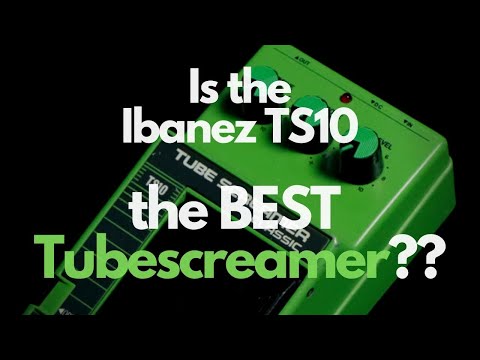

I wanted to see why this is the tubescreamer of choice for a few big players (SRV, John Mayer etc), so here is a side by side comparison of the TS10 and TS9.
The difference to me seems quite subtle, which is not necessarily what you'd expect if you believe everything you read!

    The funny thing is that you could barely give them away before Mayer became known for using one...
    I’d guess the reason SRV had one is because when one of his older models broke he just bought a new one, and that was the current version at the time... nothing to do with the sound.
    They are slightly different - more than the TS-9 is from the TS-808 - but they still sound like a Tube Screamer.

    I just recorded a shoot out between:
    Ts10
    Ts9
    Behringer Tube overdrive
    And Keeley Tone Workstation
    To be honest they're such small differences.
    @guitarcookie I just paid £195 for this one for the purpose of these videos....
    @icbm you're handy with a soldering iron etc arent you? Would be interesting to get a perspective from a real person about what the differences are...

    There is a difference in the circuit between the TS-808/9 and the TS-10 - the 10 has an extra buffer stage, but it’s in the bypass path and I think was added to cure the slight bleed-through into the bypass that the 808 and 9 suffer from (like the Boss SD-1). I would need to check the schematics in detail but I think the overdrive section is almost (or completely) identical.
    The only difference between the 808 and the 9 is two resistors in the output buffer, but having fitted a TS-9 with a switch to select the 808 values, I’m sure there is no audible difference. There can be noticeable differences between *individual* pedals due to component tolerance variations and drift over time, but that applies as much to any two TS-808s or TS-9s - and probably 10s - as it does to ones of different models.
    In short all Tube Screamers sound the same to a very close degree, and the only tiny differences you can hear are down to random variations. Assuming they all have the JRC4558 chip, anyway - there *is* a difference with other types, but ironically it’s only apparent when the gain is up close to full, which is not how it’s fashionable to run them nowadays!
    There’s a video by JHS where he A/B’d an original vintage TS-808 with a Behringer Tube Overdrive too, and they’re indistinguishable even when he switches in the middle of a held chord.
    Save your money...
    I like the TS-9 because it’s physically the most robust of all the versions, but I wouldn’t pay more than a reissue sells for. Otherwise I’d buy the Behringer.
