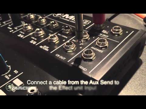

Just purchased a Mackie 802VLZ4 8 channel mixer as seen in the picture below. I’m wanting to use the FX/amp+cab sims etc from the HX Stomp for my mono synth (Arturia Minibrute 2) guitar and Blackbox sampler/sequencer.
For this set up am I right in thinking I use a balanced 1/4” TRS lead from the Aux send of the ‘Mackie’ to the Left Mono input of the stomp,  then use two balanced 1/4” TRS leads from the L&R outputs of the stomp to the ‘Stereo Return‘ on the mixer. Hope this makes sense?
