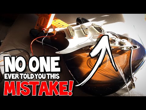

Dear all,
Sharing some tricks here, DC readings from inside and outside the guitar, how to avoid common mistakes, how to correct the values we are taking from outside the guitar by using some theory and math.
What do you think?
