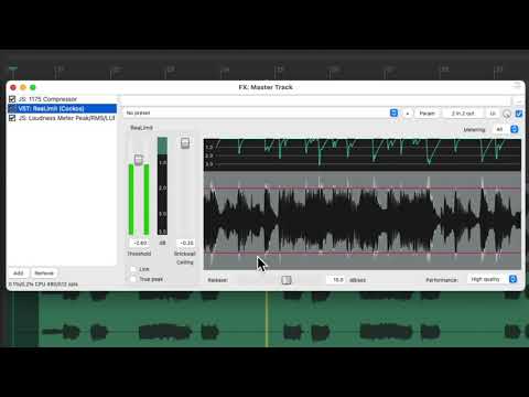

    Quick question about the limiter. I think I follow you so far up to that point.
    Is the limiter a separate fx or is it part of the compressor?
    Heres a pic of where I'm at when opening the compressor:
    So set the threshold (red arrow) to -6, ratio 3:1.
    But what I've circled in green, is that the limiter/what I set to -3 on the wet, and when you say then lower the threshold, do you mean go back to the red arrow slider and decrease, or are both the max out and threshold part of a separate limiter fx? If that makes sense?
    Thanks mate, much appreciated for everyones help so far!
    I did quickly try something I saw in a youtube vid, whereby just used the compressor, set threshold to -20db and ratio 3:1 then that made the overall audio quieter, so then the fella said click the auto make up box, which brought the volume back in. This gave the highest lufs around 13 when exported. Still sounded about the same as just turning the volume up by 5db or so when comparing to a render I tried last night.
    The only easy day, was yesterday...

  • Danny1969Danny1969 Frets: 12881
    skunkwerx said:
    Danny1969 said:
    Don't record hotter going in, no need to and risks distorting the audio. Once the audio is finished bounce / render it to a stereo wav and then do a quick and amature  "master " to that wav. That basically means putting an EQ, compressor and limiter on the master bus then try this.
    Pull down all the frequencies you don't really want .. everything below 60Hz .. and above 18Khz ish
    Set the compressor with a ratio of 3:1 and adjust the threshold so it's showing around 6dB of gain reduction.
    Then set the limiters max out to -3dB and lower the threshold until it's knocking off the loudest peaks and nothing clips.
    That will get it competitively loud. As I said it's an amature way of doing it compared to a professional master but quick, easy and effective for non profession applications like Youtube vids
    Thanks mate.
    You don't normally have a wet / dry control on a compressor.  Normally the entire signal  will be processed by the compressor so 100 wet in those terms and no dry at all. A wet / dry thing is useful for parallel compression but not for this purpose.
    By gain reduction I mean you should see the meters showing 6dB of gain reduction of the louder parts.
    A compressor squashes any audio over the threshold level by the ratio you have set. So if you set the threshold to -6dB and the ratio to 3:1 then any audio peaking over -6dB will be  squashed by a ratio of 3:1 .. it can still exceed the threshold though
    A limiter  can be considered as a compressor with an infinite ratio ... any audio exceeding the threshold will be squashed by as heavy a ratio as is needed to keep it exceeding the threshold.
    In general the compressor smoothes the audio out level wise to a large degree but some parts will still be peaky , the limiter catches and tames the peaks preventing the audio from clipping
    So I generally use a compressor AND a limiter on the master bus for quick masters to bring the level up.
    The largest level digital audio can process is 0dBFS so everything is a - level relative to that. If you can get the peaks / transients under control with a compressor and limiter then you can bring the level of that audio up without the peaks exceeding the 0dBFS and thus get it louder without any clipping.
    Care should be taken along the way though to make sure the individual tracks care under control volume wise. The better the job you do here the less you need to do on the master bus and the better the mix.
    It's all a learning curve so keep at it and have fun

    When you render the file the little waveform output panel shows clipping peaks in red so it's worth watching that panel as you render. The numeric output show the amount of 'over'. It's then a bit of a dance to lower the output volume master and hope it's under enough to conform to LUFS levels.
    No need to spend ages maxing out the levels when recording, I've had stuff at micro waveform compared to other tracks when there's been some screw up, and normalise (control shift N) makes it perfectly usable if not ideal.
