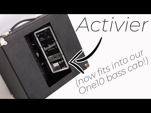

    In my experience of bad-back-inspired gear choices, it's all about the distribution of weight. A small-ish power amp on the board (like a PowerStage or similar) going into a lightweight guitar cab is the way forward, so that the bag with the pedalboard/cables/etc is roughly the same weight as the cab. I reckon that balance is somewhere in the 8-10kg range, ideally.
    I mean, the lightest option I've ever had was an HX Stomp -> PS170 -> Barefaced 1x12". Sounded absolutely great (almost as good as the Matrix 2x12", but much better spread of sound), and just a single trip from the car for everything. I'd love to be able to try the ToneX profiles I've got now with that rig in a band context, but there's sadly no chance of that these days.
    Those Barefaced cabs look really good but at circa £600 for the stock Vintage 30, these aren't cheap. They do offer lots of variations though re cab size, speaker size, and speaker type (basically any Celestion you want) & you can certainly save a lot of weight if you opt for the Neodymium (reducing weight from 10kg down to 7kg!). Interestingly I read that although these can be very bass heavy, they have a low cut filter switch that also increases power handling and reduces distortion.  Link here for those interested.
    https://barefacedaudio.com/products/reformer-112?variant=23404540526650
    But you can also have powered versions of any of their cabs, & I found this vid really interesting:
    So like everything I suppose it depends on your budget, and how fussy you are about your tone.  Personally, for typical pub and smaller club gigs for now at least I'm happy with my Tonelabs through a Headrush FRFR108, but I do still have a few different amp options if I want/need them.
    <snip>
    Yeah, the Activier cabs are prohibitively expensive compared with just whacking a pedal-sized amp on the board. The passive cabs...I think, having tried the one they donated to the forum for a bit, you have to consider them as one size up. The 1x12" sounds like a normal 2x12", the 2x12" like a normal 4x12". Then there's the sheer spread of the sound, which isn't like a normal open-back speaker at all, it completely fills the room. I actually didn't find it bass-heavy at all, even without the low-cut, but I was using the stock V30...it might need the cut if using something like a G12K, though.
    They still aren't cheap, but on the other hand...there's not really a way to get that sound in that weight and compact form factor. I mean, there's the Mesa Thiele 1x12", but that only really works when it's got the EV speaker in it, and then it weighs about as much as a small hatchback.
    If there's any prospect of me gigging again, with the arthritis in my back, one of those Barefaced cabs is basically the only way I could possibly do it. I'd most likely put a G12K in it, though, because I really dislike the V30.
