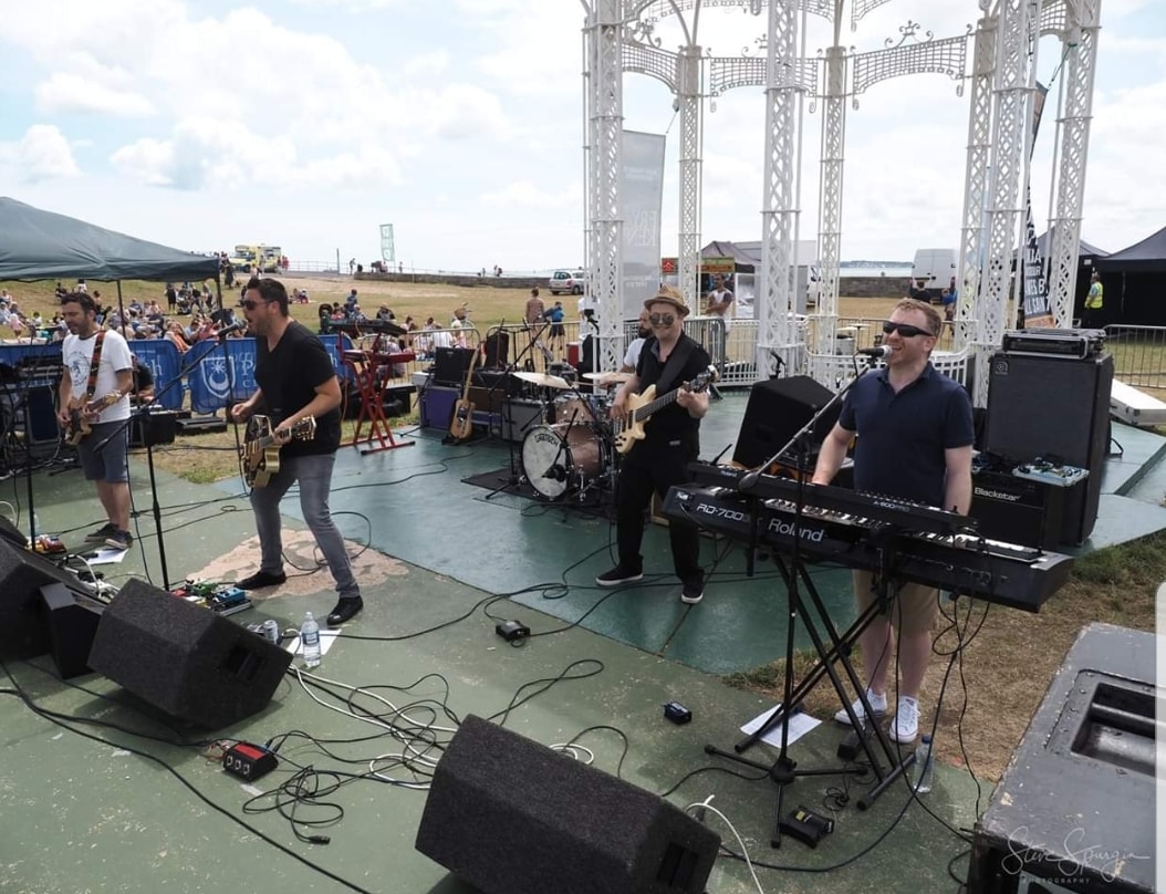

  • Danny1969Danny1969 Frets: 12919
    See what looks like a little monitor between the big monitors, this is just an empty box made to the dimensions of an ipad Pro and the iPad sits in there and the page is scrolled with a BT pedal
    0reaction image LOL 5reaction image Wow! 3reaction image Wisdom

    What guitars are you both playing there @Danny1969?
    I can't tell if I'm playing a Strat or Tele Bill, the other guys playing a Gibson or Gretch I think ?
    I actually don't know much about models of guitar.

    Yeah, you don't need a current model so an old iPad will do. The BT pedal can start and stop the page scrolling, that's generally how we used it.
    Edit :
    Photo showing front. The singer made this one, I would have put a power supply in it and a DI box so it could do double service playing music in intervals
    Put an IEC socket on the back to run the iPad and 2 XRL's for the stereo out audio and it will look exactly like a stage monitor from the audiences perspective

    That is honestly brilliant. I'd had a vague thought about an ipad and/or a box at my feet but putting IEC and audio in it is well would be genius.
    I've already told my lead singer and she wants one! I can see a project coming on. I wonder if anyone already makes one commercially? Is this an etsy thing?
    Bloody ipads and phones on mic stands are an absolute scourge imo!
