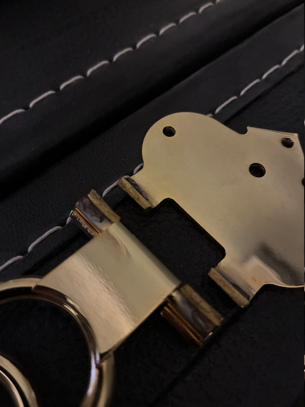

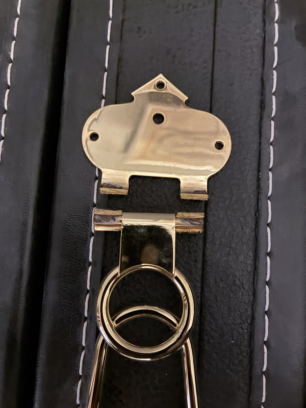

A nasty surprise to start the new year - I opened up the case on my G6136-55 to find the Cadillac G (non Bigsby) tailpiece has totally sheared off at the hinge on both sides
https://i.postimg.cc/kX30HrcB/IMG-3722.jpg
Replacements don't seem to be commercially available and I'm reading about folks getting them repaired
Has anyone got any experience of this and any recommendations on who I could get to help (either replace with something that looks the same but isn't going to fail after 2 years of babying home use or can fix this one and make it reliable?

    Have heard a few people grumble about the same problem over the years and can't believe word hasn't got back to Fender at this point, so I'd try asking them about a replacement first. For a repair there's bound to be a jeweller somewhere near you who could take a look. And if necessary, see if ABM will sell you a new one direct.

    Where exactly has it sheared off?
    The plate from the inner part of the hinge where it is welded to the ring-shaped tailpiece body?
    The screw-on plate where tyhe pin goes through to form the hinge?

    Thanks for coming back Gents - here are a couple of close up pics
    @barnstorm, are ABM the original manufacturer? ..I don't see any Gretsch stuff on their site
    https://i.postimg.cc/QxG2zLbV/IMG-3723.jpg

    looking at the metal where it hasn’t actually snapped, that also looks pretty fatigued, so I’m thinking I might be better converting to a B6 - much more robust hinge on it

    ABM are likely the OM. You should contact them directly.

    The place where the metal has broken, and what looks to be quite crystalline alloy "pot metal" visible on the broken edges, tends to make me think that it could not be successfully brazed back together and be trusted again.  The heat from brazing is also likely to discolour the surrounding plating.  As pointed out there are signs of metal fatigue on other parts that look as though they too are just waiting to crack or break.
