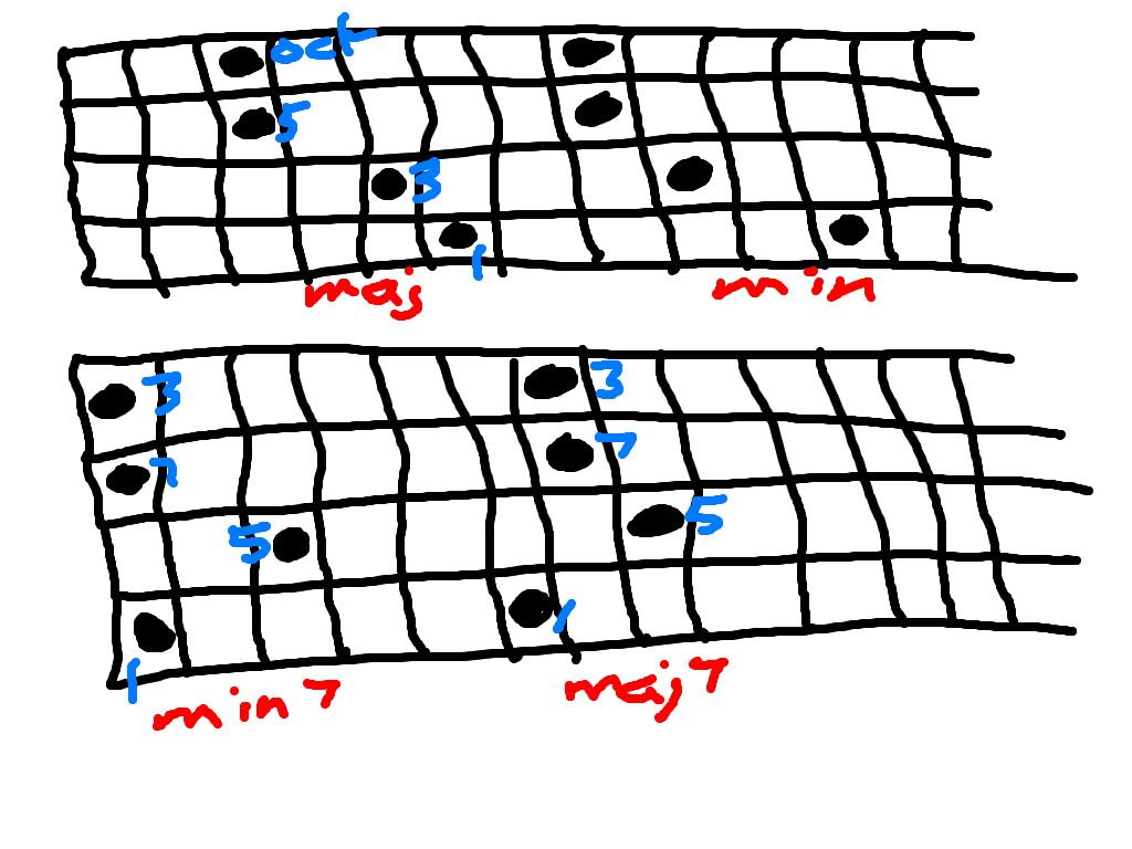

    for simple 4 note chords (you already know some shapes from the bottom 4 strings) you can simply play them across any of the 3 sets of 4 strings - bottom 4 / middle 4 / top 4
    so you can simply move the shape across the neck for A Min, to D Min, to G Min, etc - and just raise the 3rd for A Maj / D Maj / G Maj
    more complicated chords may be hard to hold, and you may have to drop some notes, but the same applies to standard tuning too
    i'll try and make a diagram later of the scale shapes and you can see how to extract the chords from them
    i dont know what chords other people want to play, for me i've always made original music and been happy to rewrite any cover songs with my own chord arrangements.
    it is harder to strum though, well, its harder to mute the unwanted strings.

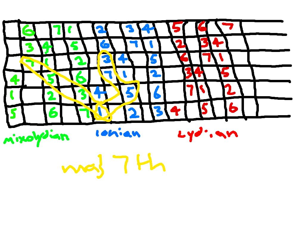

  • FazerFazer Frets: 455
    if you map out the major scale with the notes numbered you can easily pick out the notes you need to construct any chord.
    and once you have the shape/idea in your head it applies over the whole fretboard, regardless which set of strings you are on - you could play a 7/8/9/10-string guitar, you just move the shape around around and dont have to worry about that little kink messing them all up

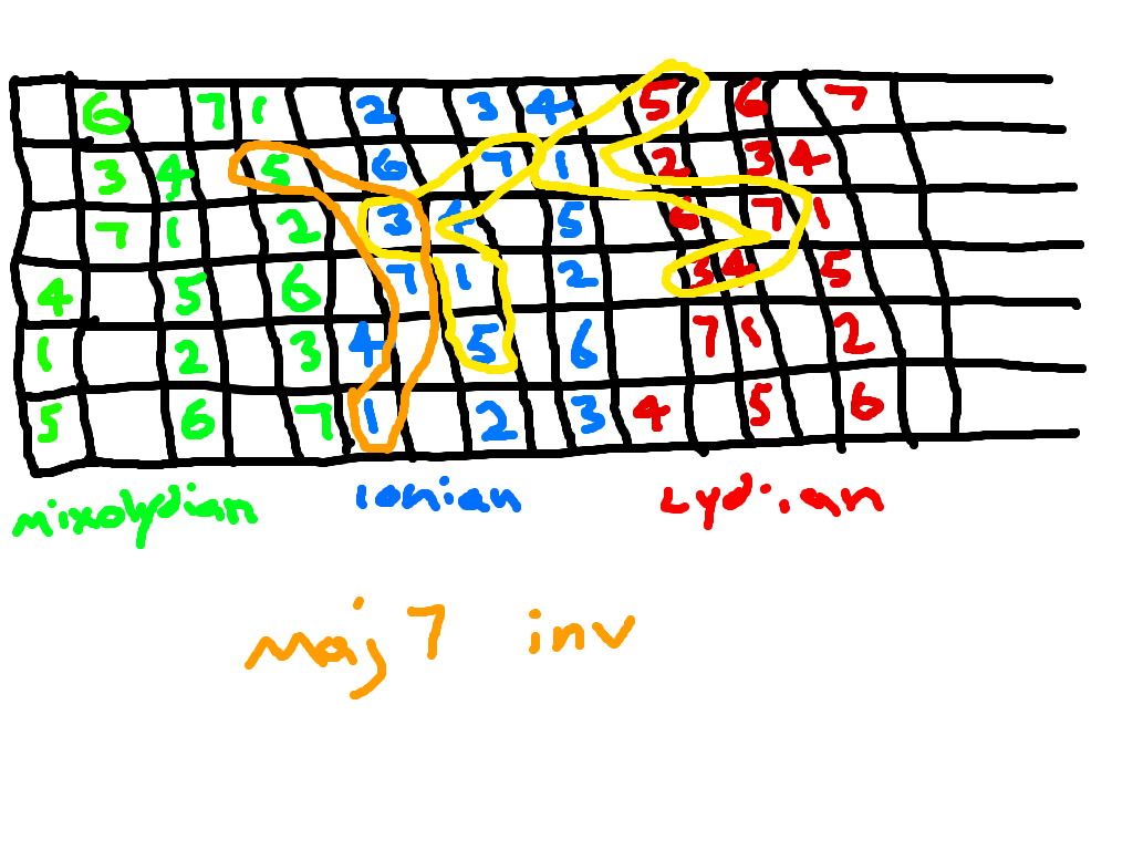

    you can play any inversions, skip across strings etc
    the only hurdle is being able to fit your fingers on them

    Thanks @Fazer, colourful and great looking diagrams too, much appreciated.
