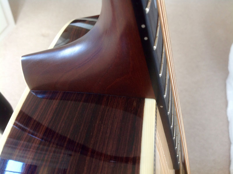

    It's on our waterborne rather than poly lacquer, but pumice powder (as used in French polishing) may work for you.
    In this picture both body and neck have been sprayed with gloss lacquer - the neck has then been brought back to a satin/matt with pumice:
    T-cut is a mid-level liquid compound (equivalent to our RF5, so midway through the liquid process) and probably won't do much to dull the finish, certainly not back down to a matte.
    Satin effects can also often be achieved with some steel wool - I'm usually reluctant to suggest this, but poly should be able to handle it.
