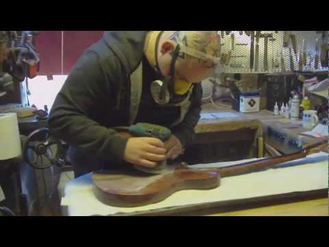

    Sanding Poly - A note here for anyone with as little knowledge of lacquers and varnishes as me, when sanding the poly, wet your sandpaper and put a very light spray of water on the body. I've seen some people suggest soaking the sandpaper for up to 24 hours. Wet the sand paper with slightly soapy water, either in a spray can or a bowel as I did. Wipe off the excess water regularly with a cotton cloth. Also clean the sandpaper in your water regularly. Don't dry sand.
    Couple of resources on sanding down lacquer for buff/polish
    Crimson Guitars
    This intro is amazing :)
