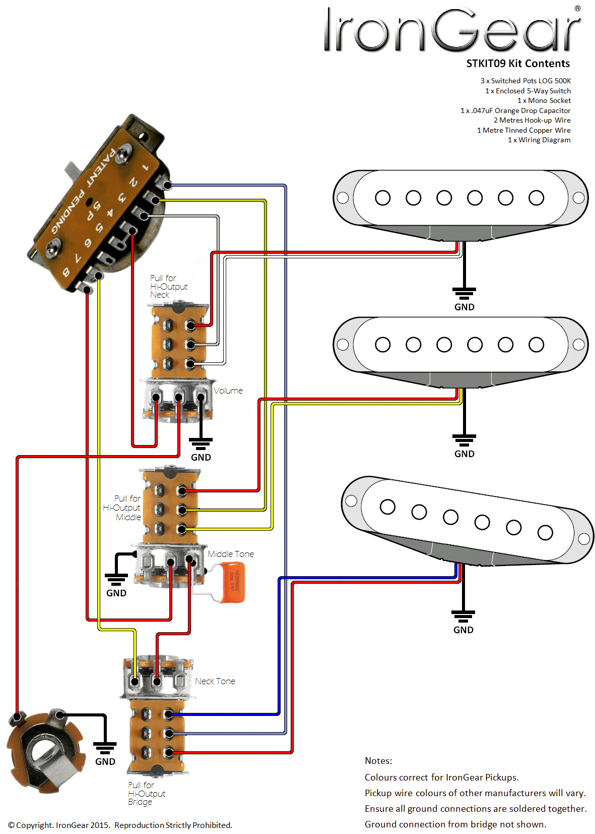

  • Iron gear smoke stack II pickup set
  • Follow this wiring kit so push pull pots with the smokestacks
