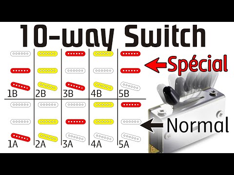

Have just watched this latest YouTube video by Darrel Braun about a ten way Stratocaster switch.
I’m gonna have to try one.
https://youtu.be/H1iCOo26bec

    I am usually an advocate for Freeway selector switches. The ten-way Stratocaster version does not do anything I would want that cannot be achieved with a CRL sprung five-way selector switch and a mini toggle mode switch.
    If you need a humbucker sound from an S-type guitar, install a humbucker on it. Job done.

    As I said on @Hootsmon's Brian May thread today, I'm not at all keen on complicated wiring or push-pull pots or mini-switches - but when it's all on one switch like this, it's quite appealing.  And the sounds are good.
  • The Brian May Red Special circuit is tedious to solder up but a doodle to operate. Each pickup is either on or it isn’t. Combinations are either in phase or they are not.
    The pre-wired scratchplate assembly illustrated in Hoots’ thread was hamstrung by the use of mini toggle DPDT on/on switches rather than sliders.
  • timmypixtimmypix Frets: 2394
    I've had the S1 switch on an American Deluxe Strat (does the same job) and my brother-in-law has the Freeway 10-position switch on one of his Strats.
    I find the Freeway much easier and more intuitive than I remember finding the S1 - I think that lends itself more to a single job, as it's just a smart push-push really - but again, the extra sounds aren't anything to write home about and remembering what's where is nigh-on impossible without having a cheat sheet to hand.

  • I've used the "les paul" type for a few years now.  As a switching option/MMI it works wonderfully.  However, it's always noisey for the first few switching actions of use.  This is true for the two that I have.  This doesn't speak well for either build quality, or longevity (wheresoever it's built).
    My Strats are configured with a push pull switch to put the mid pickup in series with the earth, this gives either the standard five (down) or NM series, M, M, M, BN series.  This is simple and easy to use and offers the useful versions from the ten way, I suggest.

  • FREEWAY UPDATE
    The side to side “bank” switching on my Freeway 3B3-01 switch just failed.
    It is possible that this was self-inflicted. It came to my attention just after I had changed the selector switch lever cap.
    On the other hand, if pressing on a switch cap is sufficient to mess up the internals of the switch, you have to wonder whether it is robust enough for a live performance environment?
  • ICBMICBM Frets: 72339
    FREEWAY UPDATE
    If it's definitely buggered and you want to post-mortem it in the interests of finding out why, I would be very interested to see pics of the insides...
