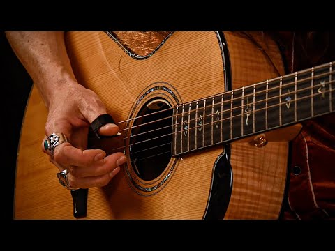

    I just don't get how anyone can use a thumbpick. For me they are all either too loose or they totally strangle my thumb. Tried a bunch of different ones years ago, eventually gave up.
    I tried Doyle Dykes one as I love his playing. I seriously don't understand how he can play with it!?!?!
    Looks like this:
