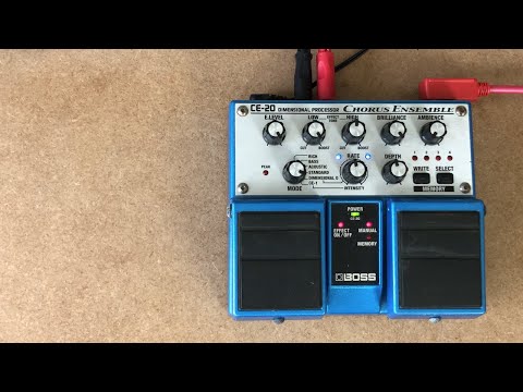

    The BOSS CE-20 twin pedal has a CE-1 emulation mode.
  • The BOSS CE-20 twin pedal has a CE-1 emulation mode.
    But does it have the same configuration as the original ?
    The manual just says it gives an analogue CE-1 chorus sound ……
