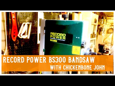

  • I've got the Record BS300  - bought secondhand with very little use on it and it's doing sterling work. Given the choice I'd definitely go that bit bigger, so between the 250 and the 400, most certainly the 400. Here's my take on the BS300.

    Very interesting John - thanks
    i am currently
    leaning towards the BS400 and having read a bit I would probably need the wheel kit, the fence upgrade they now do on the BS350, and maybe even an aftermarket top set of guide bearings rather than the flat blade guides on the BS400
    by the time Ive done the upgrades the cost is about the same as the Laguna 14BX but the Laguna is a 14” machine whereas the BS400 is a 16” machine and may have more grunt
