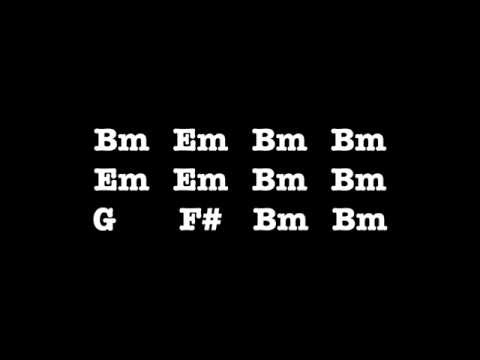

I usually do quite a bit of soloing over Backing Tracks of all kinds, but recently decided to have another crack at doing Major Blues E7 A7 B7 etc, trying to incorporate as many chord tones as possible instead of all Minor Pentatonics to make it sound more interesting.
So the above chord prog is i iv V, but in Dom 7's.
I'm also familiar with Jazz progs ii V i and ii V i VI etc
and while I solo a lot over Minor backing tracks, I never took the time to figure out what's going on in the Minor Keys.
Todays backing track was in B minor
Love Quists Backing tracks, btw.
Bmin Emin GMaj and F#Maj and back to Bmin
So is this a i iv VI V Progression? I also notice the "V" F#Maj sounded better as an F7, cadence to the Bmin.
Anyone enlighten me as to why the Bminor Diatonic lists F#min7 as the V chord (linky above), when the F#7 resolves so much better. I should know this stuff.
Thank you.
Only a Fool Would Say That.
  • vizviz Frets: 10699
    edited August 2015
    It's because only the major triad with an extended 7 is the true dominant (V) chord, whether the tonic is major or minor, and it's so effective because it has that major 3rd on the dominant which 'leads' to the tonic. That's why it's called the tonic's 'leading note', regardless of whether the tonic is major or minor. A minor V chord just doesn't cut it because the flattened 3rd is only a minor 7th of the tonic, which isn't close enough to the tonic to be a leading note.
    That's what the harmonic minor scale was invented for, to allow that major 7th in the tonic minor, over that V chord.
