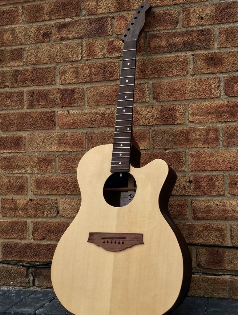

Firstly, thanks to all the help and support for my first project of this nature. It was completed and now up for sale.
Secondly, a big thanks to Steve Robinson for digging this out for me. The guitar in question is a Paul Cathcart. I think the only one he made.

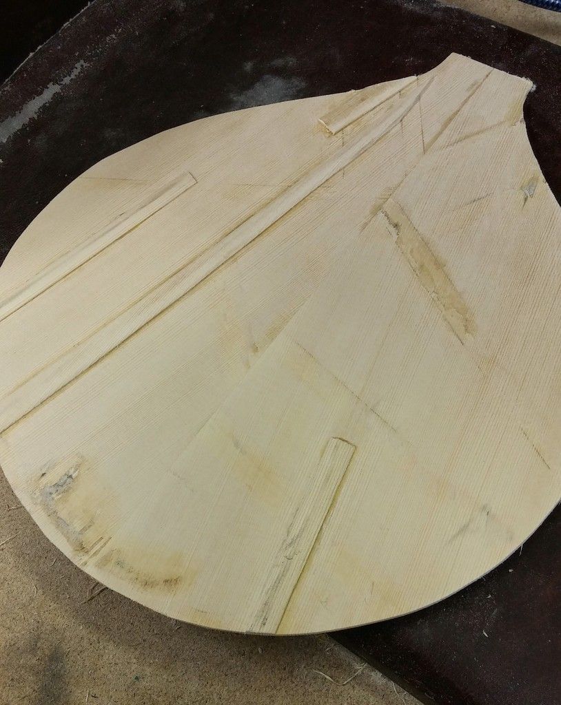

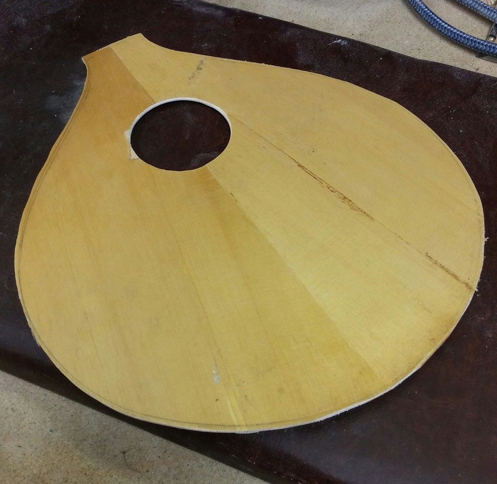

http://i301.photobucket.com/albums/nn53/parkerska/Paul Cathcart 001 into Temple Mandolin 002/C27D081B-FE4A-4278-B5E5-FE02A0C11421.jpgThis is a challenge, due to the poor top. When removing it from the sides two large splits appeared, to join the original splits that were already in the top. Having never repaired splits, I'm Not sure how hopeful I am of repairing them, but they are currently clamped up and supported by a spare section of top. Maybe I'll stick to my saw instead of the household iron in future, but the top seemed incredibly dry to begin with anyway. So bring the upcycle project on. Temple Mandolin 002.

I've actually used the same neck. Removed the fretboard and truss rod, cut the neck to size, rejoined the headstock and re-cut the truss rod channel. With these Upcycles, I'm using a simple bolt on system that is proving to be very effective.
