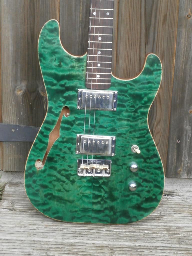

    @JohnB This is probably a better illustration.  This just has green dye applied - not even sanded and re-dyed...
    Look how much deeper the colour is where the ink has soaked into the end grain of the quilting vs the much lighter absorption at the cross grain areas:
    ...and if you then sanded and reapplied, the dark areas would get even darker, contrasting even more with the light areas that would stay much the same!
