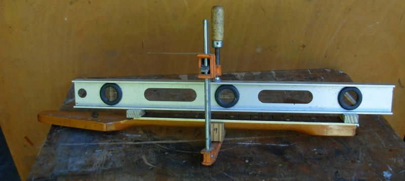

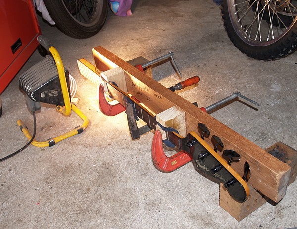

    but you should focus on getting that 3mm gap down to as little as possible.  long way is to plane or replace the fretboard and do all kinds of other structural work involving extra reinforcement and refretting
    the simplest is to try a heat treatment.   its not always 100% successful and can only be temporary as wood will continue to do what wood does, but its the least invasive way of getting this playable
    the proper way
    more diy versions
  • WezVWezV Frets: 16748
    edited October 2015
    obviously those two pics show two different bows being fixed ;)
    you do need to be careful with heat lamps, too hot will damage the finish
    essentially you want to heat it, clamp it in place with a bit of extra back bow, leave it in clamps for a few days.
