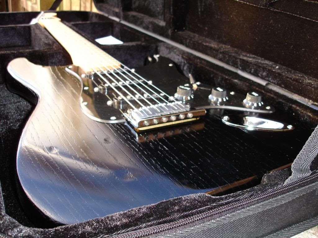

    found this on google images image
    so if I sand a body smooth, then one or two thin coats of primer, then a few thin coats of gloss with light sanding in-between, will it look like that do you reckon?

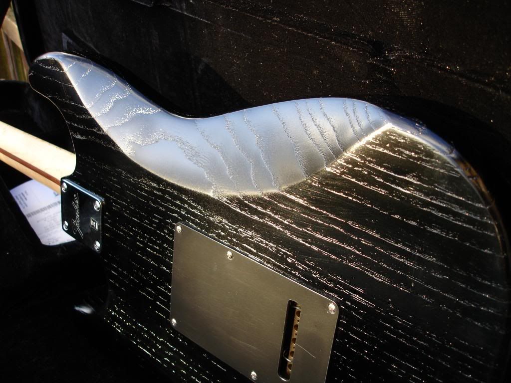

  • JtaylorJtaylor Frets: 182
    another angle, looks lush!
  • paulnb57paulnb57 Frets: 3082
    Cant say for sure how it will come out as I have never done it, but gut feeling suggests it would work.
    I'm pretty good with rattle cans, so dont sand between coats, Ive used them on several things over the years and there is an art to it.
    The two guitars that I have done were both satin black and I wanted a thin finish for the grain texture to show through. I spray by feel and the look of the finish, its hard to explain. They probably have 2 coats of primer and four of top coat. The LPJ above was sanded prior to spraying and the finished result is straight from the can.....
    That looks lovely, but I don't think you'll achieve it on your Squier.
    I'm pretty sure that's ash, with the grain like that, and your Squier is likely to be a much plainer looking piece of wood. Plus I suspect they may have done something to emphasise the grain on that Strat.
    Paging @SteveRobinson for a bit of expert input. (http://www.manchesterguitartech.co.uk)
  • WezVWezV Frets: 16815
    yes, you need the right wood first, then as long as you don't grainfill that is what you end up with
    you want to avoid having to sand back or buff as much as possible as that will leave a white residue in the grain, so if sprayign you need to get is sanded really well and give the grain a blow our with compressed air before spraying a few light coats of colour and a light coat of clear gloss.  polish with wax and a microfibre cloth (or fine wire wool if it needs a bit of evening out) for a semi-gloss finish that won't leave white residue in the pores
