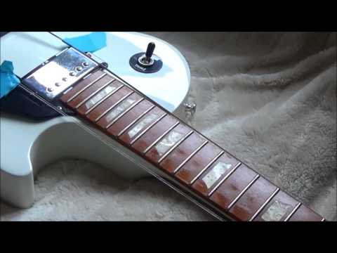

Well, when I bought my Les Paul Studio, I always remembered the Studios having ebony boards, and I loved the black/white look.  Imagine my surprise when I was browsing to find they now came with granadillo fretboards.  No problem I hear you ask, so I spoke to the dealer who said they are quite light in colour.  Now I paid my money and took my chances and low and behold it was indeed very light (as the pictures show).  I didn't mind, all I really wanted was the tone, and it sounded divine (or as divine as a 498T/490R loaded Les Paul can).
Move forward a few years and I now have the itch to modify the Les Paul.  I'm looking toward darkening the fretboard and changing out the pickguard for something a little more carbon fibre (I've got a local company where I can get a sheet of impregnated carbon sheet to custom cut a new guard).
So, the things I can start are the fretboard preparation.  I have scraped the nitro from the side of the board underneath (the side without the side dots), and boy that was fun.  I masked up and took a sharp blade, scraping carefully along the whole length.  Now it transpires that Gibson decided that they would use a fretboard that was narrower than the neck, and build up the width with at least 1mm of nitro on each side!  Crazy.  Now, once scraped, I took some 240 grit and smoothed out the edge so it feels nice and smooth.  I then went and took my prepared iron acetate and tested a patch on a scrap of wood.  It failed.  Now granted, the solution is 2 years old, and not very black any more, so I have binned that batch and have started batch 2.

Back to the Lester.  Here's some pictures I've taken already showing the current state of play.
Guard off/on - I think I prefer it on, so will definitely go with the carbon fibre guard:
Masking up:
Let the scraping commence:
Now I can imagine many are wondering why I am doing this to a USA Gibson, well, for one I intend on keeping the guitar.  I can add nitro to the edges of the board again to restore the same feel.  If worst comes to the worst and I don't like it after, well, I can always pay a luthier to install a new fretboard.  Granted it won't be original, but that point is moot as I don't intend on selling the guitar
