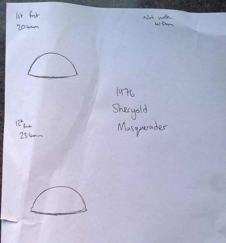

    That's the quick sketch i did when i first got the guitar.   You would swear there was very little taper on the thickness when playing it, but its there.
  • valevale Frets: 1052
    edited February 2017
    @WezV neat work WezV. so a 3.4mm increase on the thicktitude meter. thankq for that.
    actually your cross-sections gave me an idea. if i get the closest neck i can find according to your measurements maybe i can tweak the profile with neck profile templates (u-shaped wood block filled with sandpaper) according to your profiles.

    Don't take those drawings as more than a guide. For a start the paper is creased.
    it replicating a neck I normally take similar drawings at 1st, 5th and 12th.
    i wouldn't recarve any neck as thin as 20.4mm without knowing precisely how deep the truss rod was

  • WezVWezV Frets: 16851
    Truss rods vary in depth by quite a lot...
    curved single action rods work best when they are closer to the back of the neck at the midpoint of the curve.  That's most traditional fender and Gibson necks.
    modern two way rods take up more depth but there is no curve in the channel.
    That covers 99% of guitar necks
    Most truss rods sit on the centre line where the neck is always thickest.  Necks with two separate rods sit either side of the centre line and you can get away with different profiles
    both rickys and shergolds are non standard neck construction and non standard truss rods.
