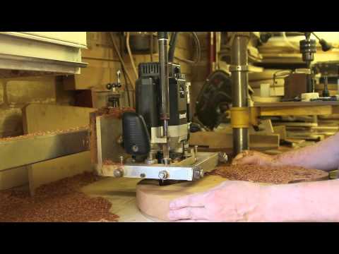

  • GSPBASSESGSPBASSES Frets: 2351
    I would definitely go for the trend T11EK, they are in my opinion the best industrial router you can buy. I might be a bit biased on this subject, as I own 4 them, that might sound a bit over the top, but when you do as much routing as I do, it is so much easier to have several router setup to do specific jobs, then to keep changing cutters and resetting the router up. I have two router setup for hand routing, one with a 6mm cutter, for routed truss rod channels, and one with a 9.5mm cutter use for pickup cavity routing that cannot be done under the pin router. I have one set up in my overhead pin router that doesn't nearly all my routing work. The fourth one I've only just purchased will be going in the overhead router. I do have a DeWalt equivalent to Trent, but to be honest with you, it's not very good. Although everyone says it's identical. It really does lack the power of the Trend, it is now only used fixed under a bench (acting as a router table) to rout binding channels in necks and head stock's.

  • Jimbro66Jimbro66 Frets: 2431
    Thank you so much for that post @GSPBASSES it is really very helpful. I have never used a pin router although I had seen them in use but not realised what they were. Thanks to you and to @customkits, plus a little research online, for educating me. Nice setup in the video. I can see how that is preferable to manoeuvring a heavy-ish hand-held - but no doubt after a lot of practice.
    Trend T11EK has the majority recommendation here, thanks all, so that's the way I'll go.
