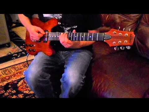

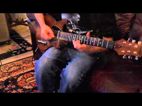

    Actually I did one the other way around... I just happened to have these planks which wernt really big enough for anything useful so I made an oak frame and put some softish meranti either side of it. So its kind of chambered but the oak obviously is solid.....
    Havent finished it beyond the body yet.. Another one of my many projects to do  :)
    So yes..  An oak frame
    https://i.imgur.com/FORuw5a.jpg
    Just the right size for the template and the frame is wide enough to take the horns.
    https://i.imgur.com/SJMs6hr.jpg
    Sandwiched with the meranti
    https://i.imgur.com/PYkjiZf.jpg
    Which I think came out pretty cool and is very light.. Possibly planning on a nice veneer for the top or make it a solid colour cos meranti is pretty plain. If or when I get the time (groan ;) )
    https://i.imgur.com/moRpvrP.jpg
    https://i.imgur.com/NFej276.jpg
    Must get around to finishing this.
