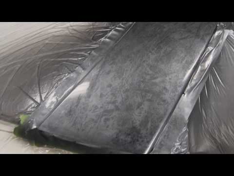

    You spray it the base colour, then the marbilzer colour, then wrap it in some form of plastic sheeting(cling film or something heavier), move the finish about by hand then remove the wrap.
    plastic bags work well... get them whilst you still can
    it gives this kind of effect
