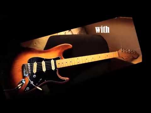

    What is it that gives you classic vintage Strat sound? Have a listen to these http://www.wudtone.com/2012/03/21/wuddys-5060-special-blends/  Marc @ MOJO pickups makes them to our spec ( we are on the 3rd variation improvement now)  and they are very sweet.    We have had trade accounts for all the larger brands mentioned. The MOJO touch ( like Ron Ellis in the USA) wins over. Not had any Oil city as yet but I suspect the same genuine handwound benefits apply to both OIL and MOJO. Service from Marc at MOJO is second to none.

    Alex Albrow  ( he is cool (ala Matt Schofield) stylist ) put the Wuddy's 5060 Special Blend pickups to the test .  MP3 link. http://www.wudtone.com/wp-content/uploads/2013/03/00alexjazz.mp3
