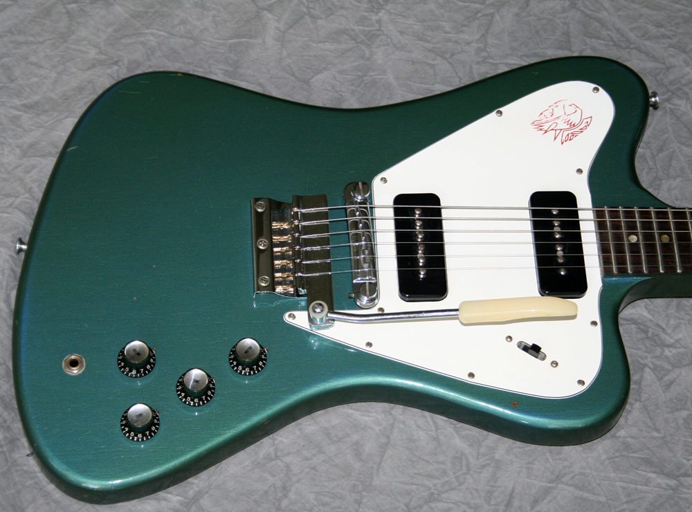

    I actually did a little sketch last December,  not to scale, but to see if fanned frets look okay on a firebird
    doesn't look too out of place.
    It wont actually have 24 frets so i can move everything into the body a bit to have plenty of room for pickups and stop it feeling like a thunderbird.  Next step is to draw it all out full size
    this kinda look, but  no bigsby and probably not quite as blingy
  • SporkySporky Frets: 28380
    I know it's just a mock-up, but to my eye it looks like Firebirds should always have had fanned frets - really goes with the shape.
    0reaction image LOL 0reaction image Wow! 9reaction image Wisdom
  • WezVWezV Frets: 16722
    Yeah, I probably won't angle the end of the fretboard as I need the room for pickups.
     But more weird angles on a design that's all weird angles does seem to work.
  • martmart Frets: 5205
    Wiz. Every fanned fret instrument I've seen looks a bit odd, especially around the bridge, but your mockup above makes it look the most natural thing in the world. The fact that the bridge lines up with the bottom edge makes a huge difference.
    I'm going to be watching this with a lot of interest!
    It might not line up quite that nicely when I do the full size drawing.
    the bridge will be hipshot hardtail with 18 degree slant,  everything else will be worked out from that.
    Maybe not, but it'll still be a lot closer than any kind of fanned bridge in a traditional body shape.
    I reckon it will look fine so long as the angle of the bridge is between the angle of the body edge and the perpendicular. That way the body edge becomes a kind of extrapolation of the fanning, in a pleasing way. Whereas with a normal body shape the edge jars against the fanning, imho.
