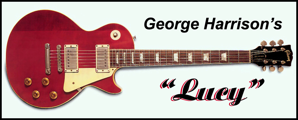

I have a Vintage V100MRPGM  Lemon Drop and I love it.
I'd like to play it more live, but as my main job is as a 'George' in a Beatles tribute, the best way of spending more time with it would be to convert it to a Lucy.
This would mean sanding the top back and staining it trans red.
My question really is about whether to try to lightly sand off the stain, or whether to go all out and sand the entire figured veneer from off the top? The original Lucy is quite a shonky looking 2-piece plain top anyway, so the latter would be more accurate.
I'm favouring the option of trying to sand off the entire veneer. I have a rotary sander to do the donkey work, then obvs I'll sand it finely to get a nice surface for the stain.
Any ideas or tips? Anyone know how thick the figured veneer is likely to be?

  • Over-thinking this probably, but what about using a darker stain on the top section to replicate the off centre seam?

    the one with the veneer removed obviously shows they don't have a plain maple top under the veneer.. but thats not really an issue for what you want to do.  The mahogany will take a nice red colour anyway.  if you wanted the two tone look i would use wood bleach on the top first to get it as light as possible.  spray it all over cherry red then mask 3/4 of the top and spray a slightly darker tint on the bass side
    if you are happy with a darker cherry red just go straight onto the mahogany
