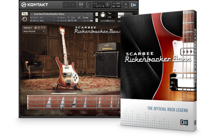

    The round robin multi-sampled 4003 sounds certainly resemble the source instrument well enough to satisfy a keyboard player - take that remark as you consider fit!but there is insufficient control over articulation to satisfy a bass guitarist.
    I have Spectrasonics Trillian. Sometimes, its stringed bass "instruments" sit in a band mix just fine. Too often, they give themselves away. Hopefully, the average listener can not tell the difference. Perhaps, I should be less picky?
    I find that, if I devise a four bar phrase then, cut and paste it in my DAW, the result will be self-evidently a cut 'n' pasted repeat but it will still have some humanity in the timing and articulation (or lack of it) in the individual notes, squeaks and scrapes. The cut 'n' paste is more acceptable than individually sampled notes.
    Keyboards do not gliss like a bass guitar.
