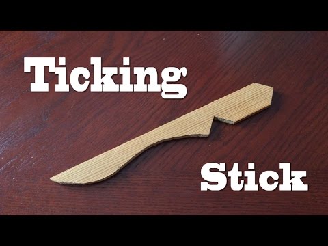

Brilliant woodworking hack: The Ticking Stick
I just chanced on this video about ticking-sticks.
I've never heard of this device before but it's a simple quite genius idea for accurately marking up difficult shape for cutting.
You learn something new ever day.

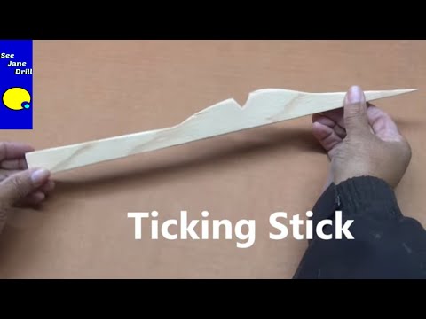

    The woman in the video is called Leah Bolden and she's got a whole tonne of amazing DIY/building tips available via her youtube channel "See Jane Drill".

    It only really works for straight lines though right ? A curved hole wouldnt really work with that stick ?
  • merlinmerlin Frets: 6744
    edited November 2019
    Not at all. It would be shit, unless you used it to draw the arc.
  • FunkfingersFunkfingers Frets: 14578
    DrBob said:
    It only really works for straight lines though, right?
    The stick can be used to register any shape. A curved shape would just require more reference points. An simple arc would be easier to mark with other tools.
    The only critical stipulation is that the surface on which the markings are to be made should not mask any of the corners of the shape being copied.
    The video mentions boat building. I suspect that the ticking stick could also be of use in stone masonry.

    OK, fl;ipped through the vid and I can see what he was doing, but I just can't see the point. He could have stuck the flat bit underneath and drawn around the shape in about 4 seconds.

    Agreed but what if the wood was stuck on the wall and you can' put anything underneath ..... this often comes up when your plasterboarding attic rooms with sloped walls due to the roof.

    Check out this video of it being used to fit shelving tight against a uneven wall.

    An interesting take on scribing in, I was taught to do this with a compass & a pencil.
