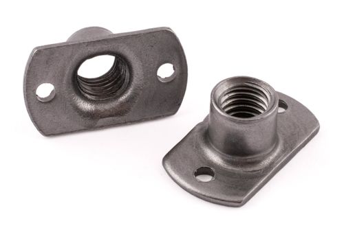

    I used "Weld Tee Nuts" M6 on my last neck for a Vader type headless build & they were great.
    Of course these only work if you are building your own Neck/Fingerboard and get to them inserted/pocket before you put the fingerboard on,i pined/CA'ed these inplace as well as them being inset in pockets so they couldn't twist.
