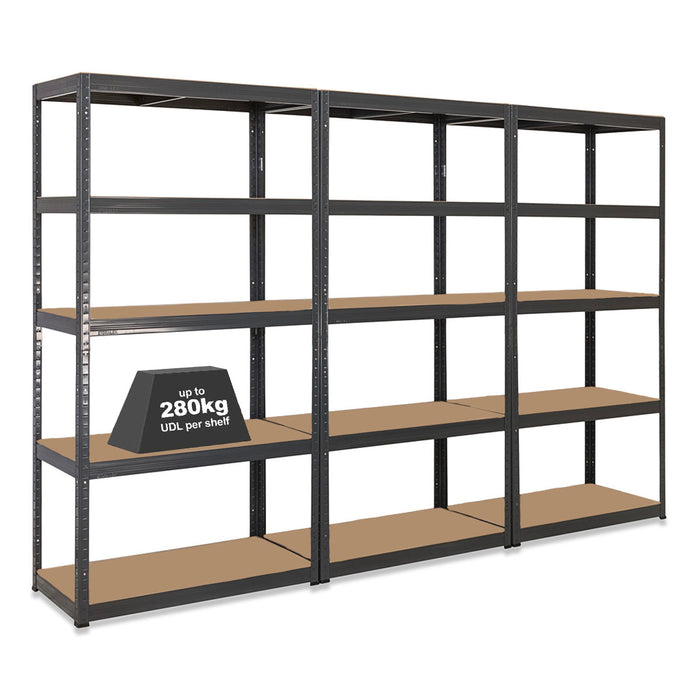

  • TTonyTTony Frets: 27601
    This sort of thing is actually quite good - sturdier than you'd expect, and you could secure it to the garage walls - and isn't silly expensive
    I've got something similar, with some old Ikea storage units on some of the shelves (to keep the dust out).
