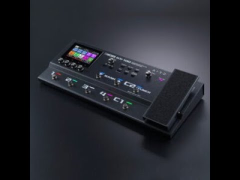

Not sure if anyone here can weigh in with some sage advice. I can't find assistance in the manual. Or the interweb. Basically I've got the GX-100 set up in 4CM with my amp and I'd like to switch channels and at the same time switch on an effect. Specifically, I'd like chorus on when I select the clean channel. So I assigned a footswitch to trigger AMP CTL and also toggle Chorus ON/OFF. The problem is...it's doing it the wrong way. It swiches chorus on when I go to the dirty channel. Which was great in the 80s but not what I'm trying to do today. Any ideas? It doesn't look like you can change the polarity of the AMP CTL and if I switch the chorus off manually (via the pedal controls or the screen) then it just ignores the first press of the footswitch and I'm back at square 1.
  • thomasw88thomasw88 Frets: 2450
    Have you tried manually switching off the chorus before hand? Ie chorus off and amp on dirty. It’s a toggle so seems to work in the state it’s at the time of doing the switch.
  • UnclePsychosisUnclePsychosis Frets: 14287
    I don't have a Gx-100 in front of me but you can invert the min/max settings in the Assign menu for the chorus and it should do what you want.
    What I'm trying to say is - go to the assign for the chorus, and turn the MIN value from "off" to "on" and the MAX value from "on" to "off".
    Similar thing done here
  • gearaddictgearaddict Frets: 985
    Brilliant - thanks!
