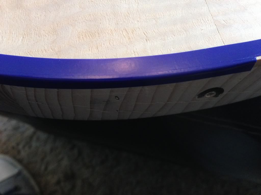

To do the edge should be straight forward enough - mask it off pre colour, do the colour and base coats on back, sides and front, remove masking and apply colourless base coat to the masked area. However, I was a very thin masked bit on the front of the guitar.
How do you do this? Do you scrape it off with a Stanley knife? I can see that going really quite wrong...

Wez, you're right. That makes it look dead easy as I'm wudtoning, I'll take your advice to prevent bleed and mask everything off and put a tiny bit of colourless base coat on the binding, before masking that and finishing the rest. Neat idea to help stop bleed.
For me, the whole cap will be the binding, so I've got the exact thickness on the guitar marked off for me - probably 1/4 inch or so. My main worries were bleed and how to get a super fine masked area on the top. I might not manage that, to be honest. I don't know if I want to scrape it, it sounds too risky for an amateur such as me...
