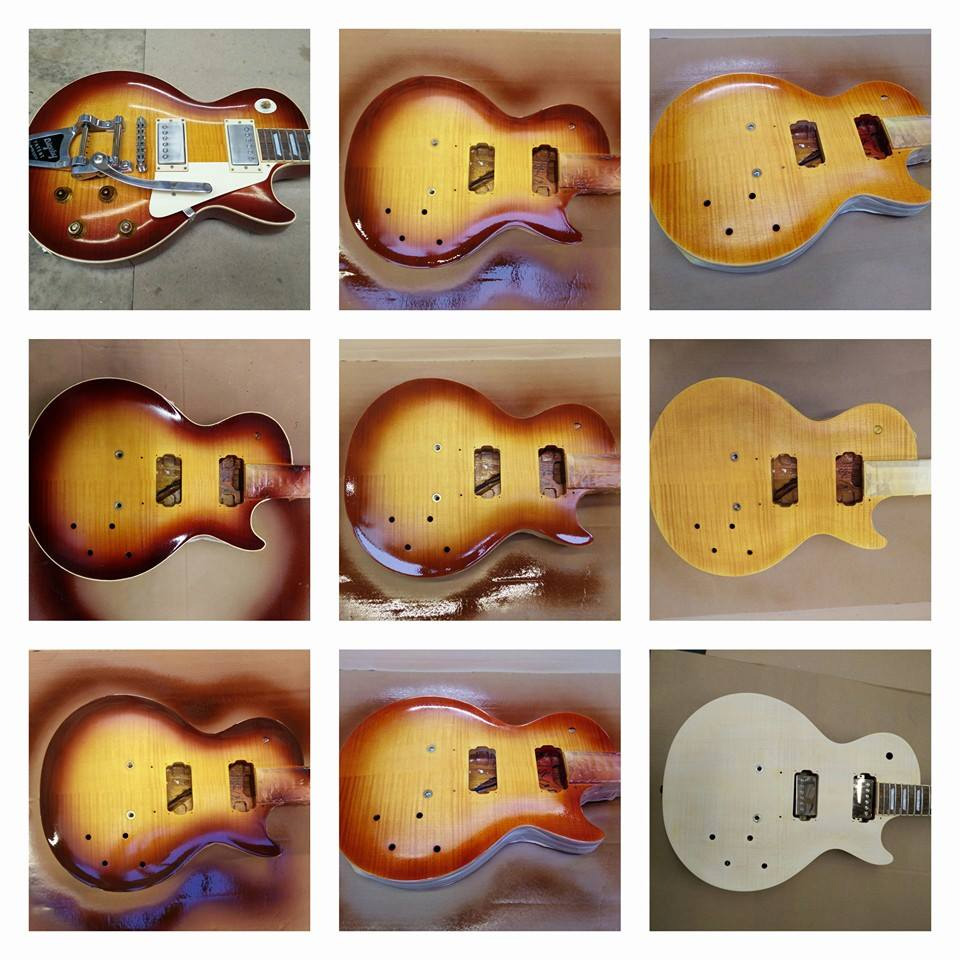

    I recently finished this les paul project using nitro spray ( heritage cherry and amber laquer ) from kevin @ northwestguitars, the finish has come out lovely. i find i do get better results using a proper spray gun rather than using the cans. but thats just me.

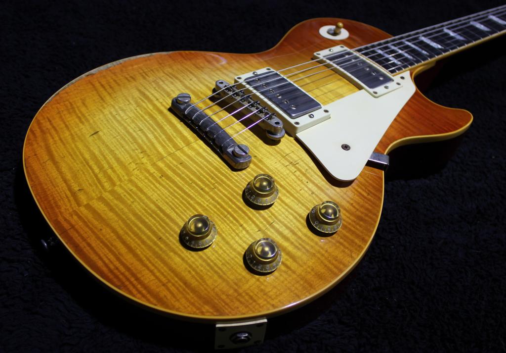

    Here's a Les Paul finished in my aniline cherry lacquer and faded.
    Here is how the colour builds with successive coats (bottom right to top left)

    @SteveRobinson your making me want to start a new project damn you. That top has a lovely finish.
