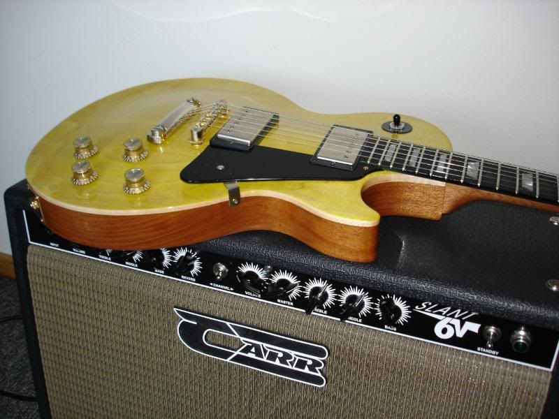

    Any hoo, I found a page with some pictures of someone who had attempted the same.  Good results:

  • paulnb57paulnb57 Frets: 3073
    Only issue is, you might not find a very attractive maple top under the paint, bit of a lottery....

  • I did this one recently, although it was an LPJ rather than a studio:
    Here was the before:
    ...and here was the after:
    The build thread is here.  Hope this helps :)

  • Here's the back, by the way:
    I stained the back, sides and neck, by the way - the timber was very light in colour under the original paint...

    That sir is a fantastic thread, thanks for the heads up :)  I may have missed it, but what did you use to strip the white from the LPJ?

    Just sandpaper.  Nitro is pretty easy to get off and there is minimal chance of damaging it.  Quite different story if you were tackling a thick poly finish - with some of those, trying to sand is the way to insanity :)
