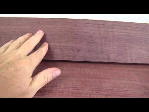

  • WezVWezV Frets: 16801
    edited May 2017
    i would test on some scrap.   it will go a bit browner whichever finish you choose, but my gut feeling is oil  will do that almost instantly.   If you bought the purpleheart for the colour, you may want to do all you can to preserve it
    http://www.wood-database.com/wood-articles/preventing-color-changes-in-exotic-woods/
  • TimberGTimberG Frets: 50
    Thanks @WezV for the video I think I am going down the Nitro route as I really want to preserve the finish and colour
