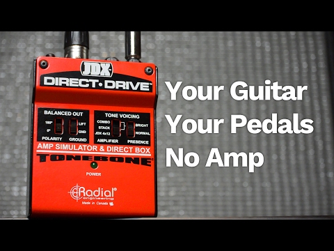

  • any love out there for the new box from Radial Engineering ?
  • octatonicoctatonic Frets: 33848
    Every Radial box I've used is pretty much perfect.
    I haven't used that one but I imagine it is excellent.
