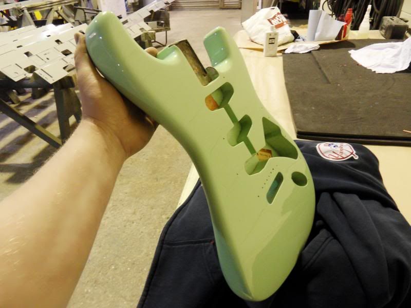

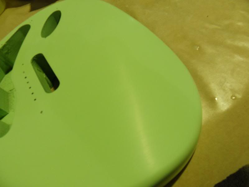

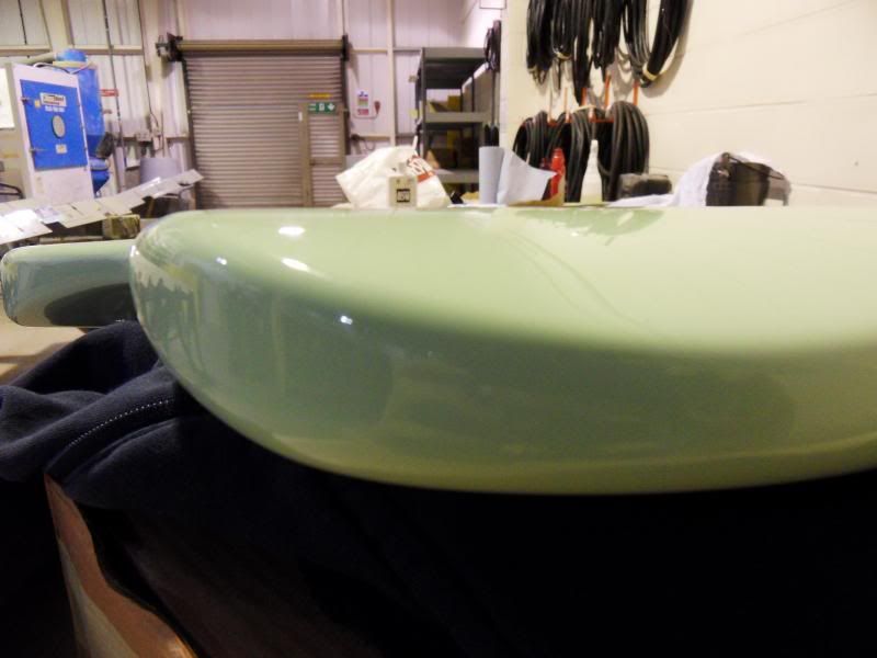

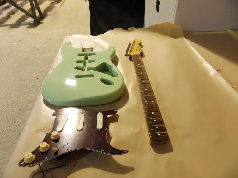

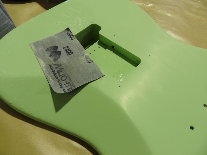

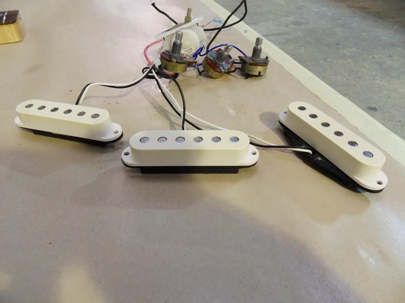

    Well, I started at 3pm. Finished primer/guide coat stage at 5.30pm.
    The finish came off really easily with a heat gun and scraper. The finish was polyurethane as suspected but nowhere near as thick or hard as the Fender I stripped last time. I used paint stripper around the horns and edges so as not to damage the wood. I have to say the wood is extremely soft and light and there is almost zero grain. The quality is no different from a Mexican Fender. It'll do it good to be refinished in a good solid coat of modern poly and I'm glad I'm taking the plunge now as it feels like I'm giving it a worthy upgrade.
    Once the poly was stripped I flatted off with a bit of 400 grade, added a couple of light coats of polyurethane primer and lastly a guide coat of matt black to assist with filling and flatting back. There are numerous bumps, gouges and scratches that need to be attended to next (when that's gonna happen is anyone's guess as I'm pretty maxed out next week!). Anyhow, here's the pics for now:
  • DeadmanDeadman Frets: 3927
    Apologies for the multiple posts but it's the only way I can get the pics to upload:
