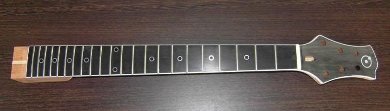

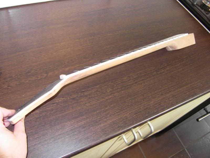

  • WezVWezV Frets: 16780
    edited March 2015
    awesome stuff  - seems to be working out quite well so far
    whenever I have done similar neck slots in caps i have routed it with rounded corners and squared up the corners by hand - usually means I can use a neck pocket template to do most of the work.
    normally i am doing it to attach full frontal a cap to a through neck guitar, rather than trying to save an incorrect neck angle.  its mostly what i did on this one, but it needed a bit more shaping by hand because of the angles
    just found some pics of the neck as it was last time i saw it
