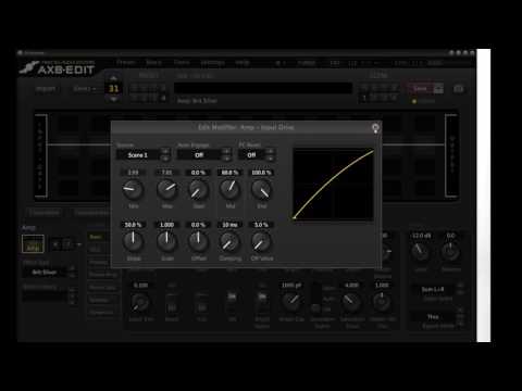

    @peteri not sure if you've stumbled on scene controllers yet, but by using those to manipulate input trim, input gain, master volumr and level you can go from "clean to mean" seamlessly via scenes in a single preset.
    It can take a bit to get your head around but was a gamechanger for me with the AX8.
    In case you're interested here's a video tutorial so you can explore it for yourself.
    It's stuff like that which makes this an absolute no brainer, for me. Great piece of gear.
    I didn't know scene controllers could do that. Got me thinking about some really cool stuff now. Amazing.
